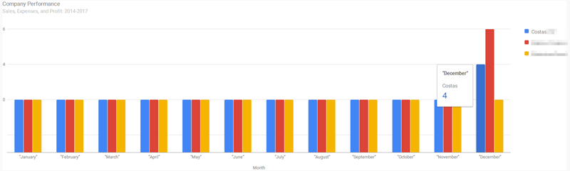

dynamic add columns to Google Bar Chart!
http://google-developers.appspot.com/chart/interactive/docs/gallery/columnchart
//sample1
$chart_row_setup = array();
$chart_columns_setup= array();
$chart_columns_setup[]="Type";
$chart_columns_setup[]="Income";
$chart_columns_setup[]="Expenses";
$chart_columns_setup[]="NET";
//chart legend
$chart_row_setup[0] = $chart_columns_setup;
for ($i=1;$i<12;$i++){
$col_vals= array();
$col_vals[]=monthName($i);
$col_vals[]=(int)$ListOfBalanceRECS[$i]->income;
$col_vals[]=(int)$ListOfBalanceRECS[$i]->expense;
$col_vals[]=(int)$ListOfBalanceRECS[$i]->net;
$chart_row_setup[] = $col_vals;
<script type="text/javascript" src="https://www.google.com/jsapi"></script>
<script type="text/javascript">
google.load("visualization", "1.1", {packages:["bar"]});
google.setOnLoadCallback(drawChart);
function drawChart() {
var data = google.visualization.arrayToDataTable(<?= json_encode($chart_row_setup);?>);
var options = {
chart: {
title: 'Company Performance',
subtitle: 'Sales, Expenses and Profit',
var chart = new google.charts.Bar(document.getElementById('columnchart_material'));
chart.draw(data, options);
//sample2
//get users
$chart_db_users = getSet($db,"select user_id,fullname from users where user_level_id in (31,42,59)",null);
$chart_columns_setup[]="Month";
for( $i= 0 ; $i <= sizeof($chart_db_users)-1 ; $i++ )
$chart_columns_setup[] = $chart_db_users[$i]["fullname"];
//always on 0 array position are the bar names
//below merge the bars values
$col_vals= array();
//for each month
for( $m= 1 ; $m <= 12 ; $m++ )
$col_vals= array();
$col_vals[]=monthName($m);
//construct valid date for mySQL
if ($m<10)
$start = date("Y-0{$m}-01");
$end = get_end_of_the_month($m,date('Y'));
{ $start = date("Y-{$m}-01");
//for each user
//query with date between depends on $m variable
$col_vals[] = (int) getScalar($db,"select count(offer_id) from offers where offer_seller_id=".$chart_db_users[$i]['user_id']." and offer_proposal_date between '".$start."' and '".$end."'",null);
$chart_row_setup[]=$col_vals;
//http://edpriceishungry.com/2010/01/04/converting-integers-to-monthnames-in-php/
function monthName($month_int) {
$month_int = (int)$month_int;
$timestamp = mktime(0, 0, 0, $month_int);
return date(“F”, $timestamp);
function get_end_of_the_month($month, $year) {
if (strlen($month)==1)
$month="0".$month;
//t returns the number of days in the month of a given date
$d = date("t", strtotime(date("{$year}-{$month}-d")));
$m = date("{$year}-{$month}-{$d}"); //format back to mysql style!
return $m;
//pass array to javascript
var options = {
chart: {
subtitle: 'Sales, Expenses, and Profit: 2014-2017',
